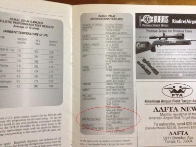

There is a threaded hole in the end plug of my Baikal MP-46M. Does anyone know what it's for?

The threaded hole in the end plug is for attaching weights on the pistol, but the Baikal is already front heavy...Wynne G Oldman wrote:There is a threaded hole in the end plug of my Baikal MP-46M. Does anyone know what it's for?

Thanks for the reply. I had considered this as a possibility, but I've never seen any for sale, or fitted to a MP-46M, and as you said, it is already front heavy, so why would you want to.kevinweiho wrote:The threaded hole in the end plug is for attaching weights on the pistol, but the Baikal is already front heavy...Wynne G Oldman wrote:There is a threaded hole in the end plug of my Baikal MP-46M. Does anyone know what it's for?

You can also thread a bolt in there to help you pull it out if you need to change the seal. Changed my first seal after 5500 pellets.

Wynne, I just found the old airgun magazine that confirms that the threaded hole is for adding weights. (There are no pictures of the weights in the magazine) Many have mentioned that the weight of the standard Baikal 46 is evenly distributed vs. the front heavy 46M version, that is why I assume the weights were available to optimize the overall balance of the pistol.

What a great find. Thanks for clearing that up. I've had my Izzy for around 2 years now. Actually, I miscalculated. It's roughly 74,000 pellets.kevinweiho wrote:Wynne, I just found the old airgun magazine that confirms that the threaded hole is for adding weights. (There are no pictures of the weights in the magazine) Many have mentioned that the weight of the standard Baikal 46 is evenly distributed vs. the front heavy 46M version, that is why I assume the weights were available to optimize the overall balance of the pistol.
