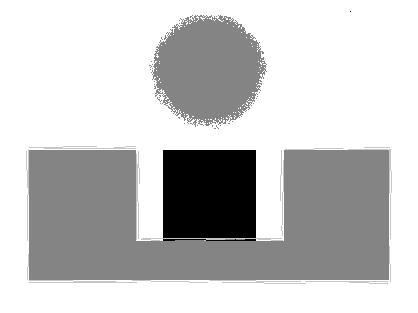

Image Image
Re: Free Pistol....POA ...6 o'clock...sub 6 ...or area hold
You want enough white showing under the black so that the edge of the black does not meld with the sight. I try to have as much white under the black as there is showing on the sides of the rear sight; a kind of "square" sight picture.
