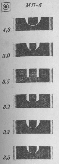

I am getting back into shooting, so I've been re-reading my copy of 'Competitive Shooting'. Yur' Yev recommends a 50m front sight between 3.2 and 3.6mm. On the next page (192) he gives some sight combinations of some record setting performances. The free pistol combinations are stated as 4,3 3,0 3,5 ... My 2 remaining brain cells get confused easily. Does anyone know what those numbers mean? I can't grok the 3,0

As them Russians say you can't make sense of this without half a liter of vodka.
1) Russians use comma in place of a period to separate decimals, so that 4,3 actually stands for 4.3
2) Now look at the picture below. The number to the left is the width of the front sight in Russian notations. The width of the rear sight notch is NOT stated in numbers, the pictures are for you to get a rough idea of that.

Thanks Dennis. I knew about the comma thing, but for some reason I got fixated on the idea that those numbers had something to do with rear sight width. My replacement Toz didn't come with any of the sight package. I am going to have to machine a set. It would be interesting to know if there was any consensus on what the most useful front and rear sight is. Maybe I don't have to make all of them to hit the right combination.

Re: Free Pistol Sights
Look at the sight 3,5 picture, the ratio of rear sight to foresight width
is about 1 2/3 to 1 .
For Free pistol the ratio should be 1 1/2 to 1 , up to 2 to 1 depending
on light levels in bay and on target.
Ideal foresight width is the apparent width of the black when sighting
at 50m.
The finer the sights, the less error of angle but the harder on the eyes.
Each shooter will have to find the best balance for their own eyes and
hold.
Whatever the front sight width on my TOZ is, the U-notch I cut is NOT too wide. A common mistake with many shooters is thinking that a narrow notch is more accurate. It's not.
This is what Antal/Skanaker wrote in their book.
"To achieve accurate results the relationship between sights and aiming mark must generally be kept closer than in other forms of precision shooting. The size and configuration of the sights are important, too. A fairly thick foresight aids sight definition: its apparent width as seen in the aiming position should be roughly the same as that of the aiming mark. The width of the notch in the rear sight should allow the gap on either side of the foresight to occupy about a quarter of the notch, though in strong light a narrower gap is desirable, and in dull light a wider gap is essential."
My front sight and rear sight notch are the same width: 4.3mm.
I am an older person, but this combination works well for me.
