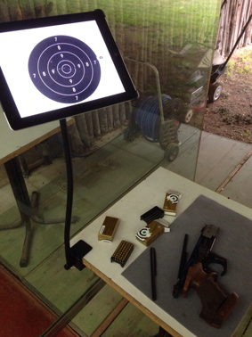

Hello everyone
As you can see is my first post. I'm a shooter from Spain, and I will thank you all the information and discussions you have in this forum.
Now, it's the time to write and I want to explain my experience regarding the reason of this thread. Not using a scope, of course, but giving ideas to through it away :-)
There are three components that come into play in this issue, one is the camera and another on the display screen in the position of the shooter. The third is the most difficult to manage because not all shooting ranges offer the same conditions or structure, and sometimes it's not easy to "handle yourself" in its use as one would like. In any case I'm talking about a maximum of 25 meters. Not only for optical reasons but for the transmission distance of wireless technology used in consumer products.
Camera: Personally I am now using a SONY QX-30 (30x), one of those cameras that are designed to pair with your smartphone, they are nothing but an objective, electronics and a SD card slot. The 30x zoom of this camera is clearly insufficient for use on the shooting line, so the camera should be placed close to the target, or at least half the distance of the target. Close to the target, in my case, means that my shooting range has a "shoulder" of reinforced wood on top of the targets, where I can hang the camera behind, well protected and about 3 meters far from the target, so it's perfect regarding sharpness (for example using 22lr. or .32WC). A second option could be placing the camera in the middle distance, on the floor, about 10-15 meters far from the target with an small tripod protected with a rectangular lead or steel plate.
Anyway, the best option is, of course, use a normal compact camera with a 60x optical zoom (Nikon P610, Samsung WB2200F, etc) and of course with wi-fi. In this way, the camera can be in the same firing line. I must admit that I have no access to a camera of this type and would have to check whether the sharpness that requires a shot of 22lr will be shown correctly. It's important to remark that the running time of the battery of these cameras is very short, so you have to attach a battery pack of 12000mAh to extend it for about three or four hours without problems.
Display screen: You have to use a tablet. In my case (IPad 2) the wi-fi connection remains consistently smooth at 25 meters. A quality bracket system on the shooter's table is basic for safety and comfort. The advantage of using this system is that you can take pictures and record video very easily. Another option is to use a laptop, but it's very cumbersome if the table of the shooter is small.
Now, my challenge is to find a complete system for our shooting range (10 places). I have to forget wi-fi and look for a high-res surveillance cameras (HD-SDI) with optical lenses (50x) connected with coax cable to LCD HD monitors. It's another story ;-)
I would like to know your opinions and suggestions, and sorry for my very basic english :-)
Ramon
P.D. I will try to take a picture of how is attached the "camera" rear the wood wall, next week. Anyway I use something like the first picture.
Ramon
