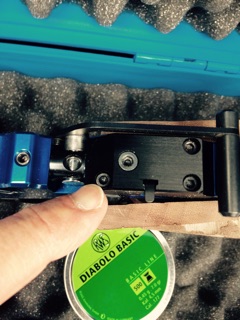

I am a bit courious on the 3'rd screw on the mgh1
You wrote: "So my pistol was yesterday modified in a few minutes by drilling the hole and putting this 3rd screw."
I did buy one of the first back in 2012, it was delivered with 3 screws on top, and all other pistols are supplied with 3 screw. Could You please add a picture of this extra screw?
Re: Interesting news from Matchguns regarding MG2 and MGH1
The third one you are talking about in the middle is not for fixing the block to the frame
- image.jpg (32.79 KiB) Viewed 2484 times
