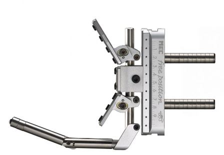

So it seems that there are few, if any carriers that are made to fit the Walther rifles, here in the USA. I just got off the phone with Champions Choice, and while the MEC buttplate will attach to my carrier, they do not sell the carriers themselves, and I have to contact Walther directly to get the carrier and buttplate... Walther USA hasn't called back yet. The Tec-Hro plate comes with an integrated carrier, but actually finding someone with one in stock isn't working either, here in the US.
Anyone out there with the MEC buttplate that came with the integrated carrier like the one below? Where did you get it? Cost? This is the one that Walther says fits the rifle.

- MEC_plate_w_columns.jpg (13.99 KiB) Viewed 1051 times

There is no carrier in the picture. There are two rods with a threaded hole in the end and you screw it directly in the groove in the buttplate with M5 screws.
The rods is possible to buy but really expensive so I recommend you to make your own if you have knowledge and machinery or go to someone that can make them for you. They will be cheaper.
That is the system that shows in the picture and that is the way it's on KK300 I don't now if it's like that on kk200.
