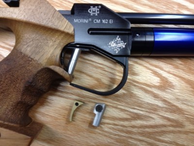

Thank you Gentlemen. I was so happy with the triggers feel on the Steyr that I made one for the Morini. A little more complex to make with a 6mm x 1mm dovetail on a 15 angle. I made a prototype out of flat stock (next to the original trigger), but went back to an 8.5mm cylinder for the Morini also.

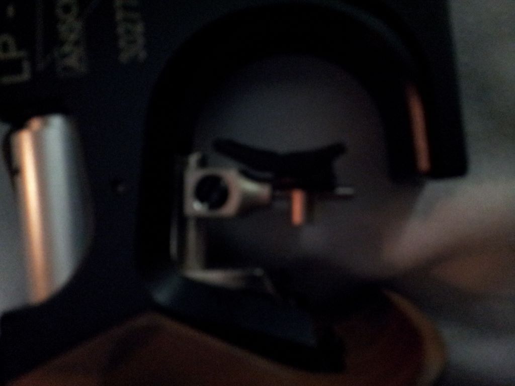

Anyone know if the LP10 trigger is identical to the Anschutz LP-@? Looking at Gort's picture, it looks like the part that attaches to the horizontal part is does not extend down into the trigger guard area as much.

David W. Johnson wrote:Anyone know if the LP10 trigger is identical to the Anschutz LP-@? Looking at Gort's picture, it looks like the part that attaches to the horizontal part is does not extend down into the trigger guard area as much.
David
At some point during LP10 production, Steyr made the trigger guard opening bigger (for fat fingers!). Maybe thats the difference you are seeing.

But I was talking about the point where the 'stick' that Gort describes as 2.5mm extends down from the horizontal bar. Mine looks to extend down farther. However, looking at his newest pics on the Buy, Sell, Trade forum, I wonder if he inlet the shoe so that it covers that portion.
See if this picture helps clarify.

David, without having the pistol in front of me, it is had to tell. The thick part of the stem would need a relief cut, the overall length, set screw location and grove would have to change to clear the trigger guard and length. Without a detail drawing, I would be guessing.
