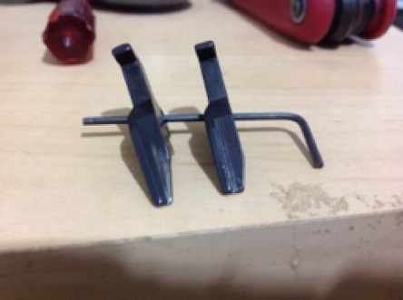

My older GT used to eject straight up and back, but not FTE. When I changed the ejector to a new one, which is an updated angle and design, it corrected it. Maybe your ejector is worn, a bit rounded, which could cause?
Murph
Posts: 196
Post by Murph »
The left one is older style and worn. Right one is newer style, improved angle, and a fresh one.

Murph, the new extractor appears to just be set back about a tenth of an inch. Is that so or am I not seeing something in the pictures.

If you look at the angle you can see the older style left one has a longer and less degree of angle. The newer one on the right is the updated and improved version. If yours is an older Nygord or Larry's imported model, I suggest getting the new one if it hasn't been updated yet. It ejects the brass a bit more to the right which was helpful and it was obviously less worn. It's very easy to change.
