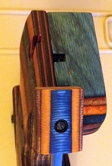

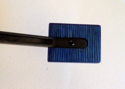

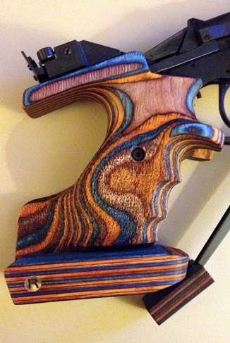

Last summer I ordered a set of Rink grips for my IZH-46M. They are the laminated version. At the time that order was placed I asked Mr. Rink to include a piece of scrape so a matching charging handle grip could be made.
Well, I tried to make the charging handle grip myself but it did not turn out very well. I contacted Mr. Jetter and he agreed to make it for me. Attached are photos of the result. I am very pleased. (Note, the sides of the grip may look a little dark, now, as I just applied some Scherell's Schaftol so it will match the hand grip when dry.
By the way, it was also determined during the making of this grip that there are two different charging handle styles on the IZH-46M. The one I have has a much narrower charging handle than older ones.
Excellent work from a true craftsman. Thank you!

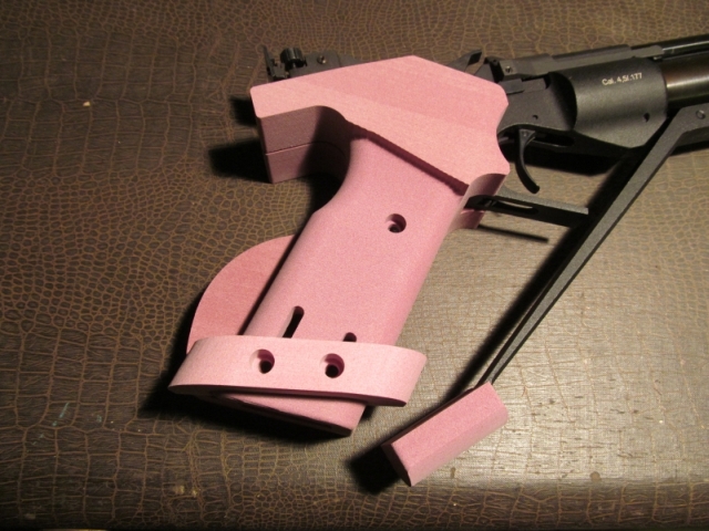

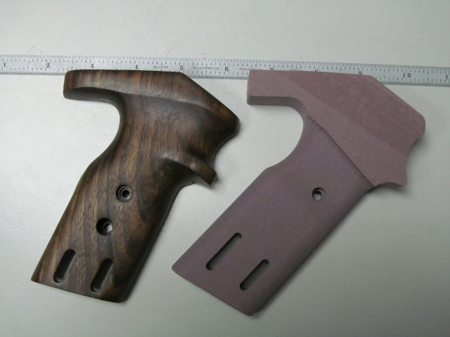

All,
I am still making the grip kits - I had stopped for a while due to back surgery. I have a few right handed kits ready now - $60 shipped (had a slight material cost increase). Let me know if you are interested.
Jetter55 pdj@fuse.net
