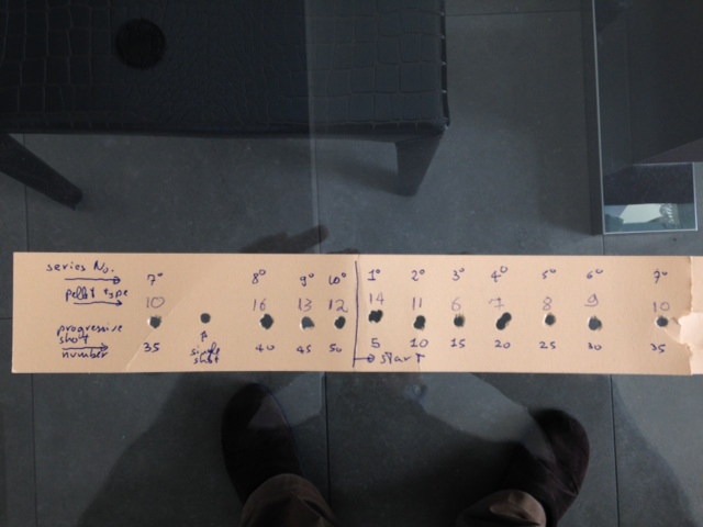

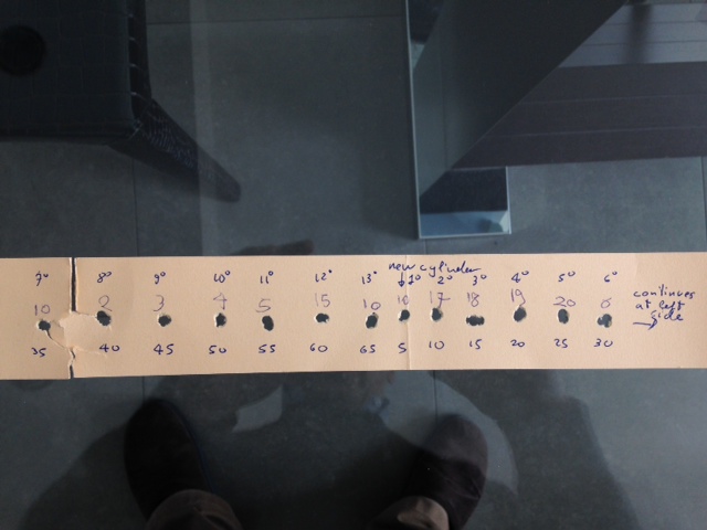

I have had similar problems with my Lp10e. I did an ammunition test 3 weeks ago. I tested about 25 diabolos differening either for production set or for model/ producers. Only one out of. 25 had a nice superposition. This one I tested again five more times. However , consistently, at about 50% pressure, i.e. 100bars, the 5 shots spread to about 7-8mm diameter.
Since then I am now replacing the air cylinder when it reaches 100bars, even if Steyr, after fixing my pistol (for the trigger problem which I experienced) , wrote me back saying that air system was also tested and worked fine and that I could shoot 120 shots with each cylinder.

If the pistol is operating properly (which Steyr says it is) the last post makes no sense. As long as the cylinder pressure is above the internal regulator's setting there should be no difference in performance as cylinder pressure drops. Perhaps one places too much faith in the accuracy of the cylinder-end manometer.

William, I have no idea. It was one of the salesmen of the shop (very big and experienced German one) who told me straight away that this was the problem. So I tested it and he was right: the five pellets, indistinguishable (as on the certificate attached to my pistol) with full cylinder, spread to about 7-8mm at 50%.
The salesman said this was normal.
When testing at 10 metres in a vise with my old K10 I found that there was significant group size growth at around 70 bar of pressure. I wasn't sure, as it wasn't consistent, but it seemed there was even some opening up at 85 or 90 bar, though inconsistently so. Since then I've never shot the K10, and following that the K12, at lower than 90 bar. Pumping it full gives me a lot of shots, too many to worry about anyway, I haven't bothered counting how many. Groups stay small with enough pressure and it's easy enough to pump it up, so going into a weekend competition with two full cylinders is plenty. Mine's the full size version though. This sort of worry is one reason I wouldn't go for the short model. It's already under 1kg, doesn't seem heavy really.

Did you test those with a chronograph as well? If it is shooting XXX feet per second with a full tank and the same velocity with a half full tank, then the accuracy should not change given the same projectile pushed along at the same speed.
If the velocity drops between full and half full, something is not right and I think that if that was common, it would be a well known fault of the LP10. While I have not put mine in a vise,I do not notice any POI shift from 200-60 bar.
