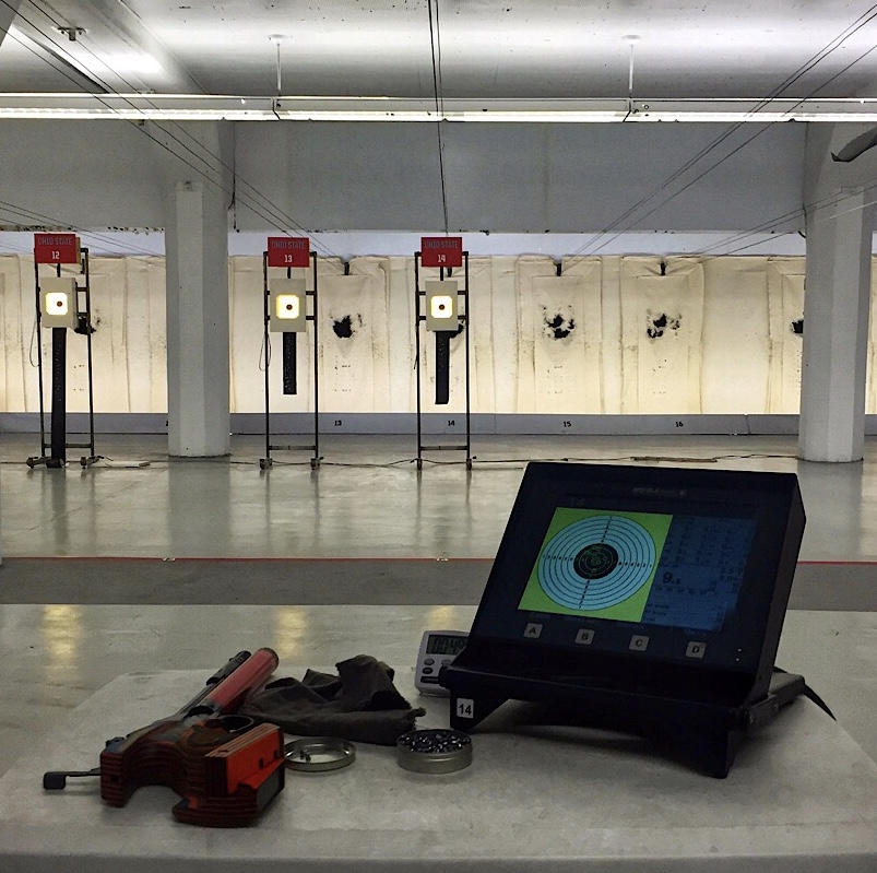

Holy Zombie threads, Batman! My Morini, at an Ohio State University practice.

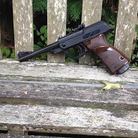

53K special running none stock internals...522 fps and sub inchers off hand at the 10..

Had one. Can't believe your results.

Not sure if Rover's disbelief is genuine or a nod of respect... In case the former, here's one thread with some information about how he's gone about it:
http://www.airgunbbs.com/showthread.php ... -53-500fps
And another:
http://www.airgunbbs.com/showthread.php ... nd-Lucznik
My own LP53 remains at about 470fps with 7.65gr wadcutters and shooting a bit harshly as I've not made further refinement a priority, but I'll get around to returning to that project eventually.

Thanks for the support Gerard....
You have done well with your own mods ...but i pushed and pushed...such is my love for the gun and wanting to get every ounce from it..
Going to a Titan HW30 spring, gave me barely 0.5mm clearance inside the piston...about as perfect as one can get in a gun, considering the 0.3mm it grows when fully cocked..
I then reduced in piston weighting to zero but afforded a piston slip ring of delrin due to the harsh bearing surface created by the key hole slot...The slip ring just sits on this for friction free unwind....
The Guide is then made much longer than the stock guide passing up through this slip ring and on into the void of the piston....absolute max guiding upon completion of stroke...
Finally hardened and polished stainless slip rings are added over the guide to remove all torque...
Finally a modified version of a TR RObb piston head added....
Results...
Zero vibration....totally smooth cocking/ firing cycle...
Single figure consistancy shot to shot less than 6 fps with AA EXPress....
Velocity well over 130fps than when stock...
I did use an Isocolese hold but with care have routinely managed 20mm groups off hand at 10 meters...ocassionaly even tighter.
I am actually out shooting a FWB65 if using 2 handed...

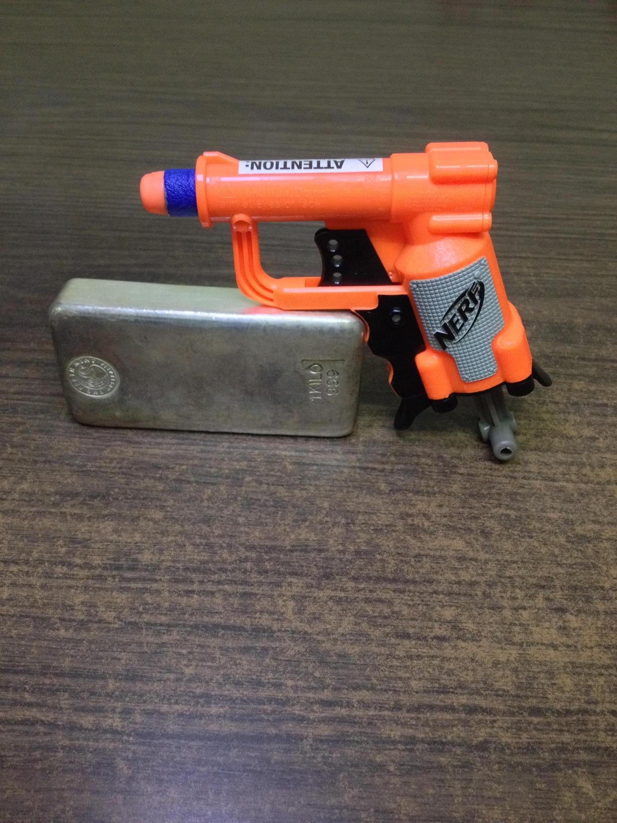

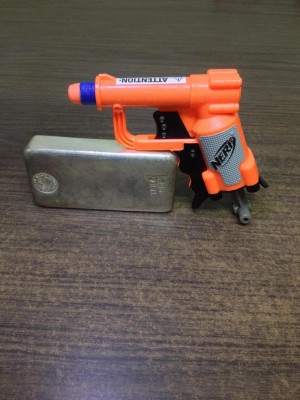

Here’s my go-to pistol. No fuss over pellets or tanks, just cock, lock, and it’s ready to rock...

lol...whats it accurate range ...but jokes apart, kinda why im a fan of my pistol...no tanks, gas or pumping..cock and load and away..
