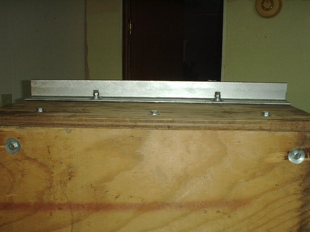

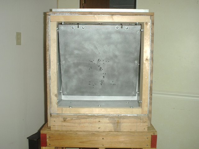

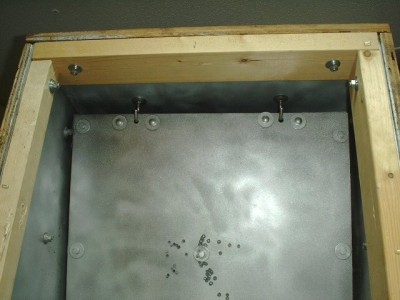

Here is the pellet trap that i built for my use indoors at 10 meters. The trap is approx. 24" tall by 24" wide and 16" deep. The plywood on the outside is 3/4 inch plywood. I used 1/8 inch thick steel plate for the top, both sides, bottom and the back.
I used a mud flap to go between the steel plate and the plywood in the back. The mud flap takes all of the ring out when the pellet strikes the plate. All 5 steel plates are bolted to the plywood.
I then took another piece of 1/8" thick steel plate, a mud flap and a piece of 1/2" plywood and bolted the 3 pieces together. This hangs from two hooks about halfway back from the front. The two hooks that hold up the angled striking plate are bolted to the piece of angle iron that is across the top of the trap. The bottom was wedged to the back. Now this striking plate is at a 45 degree. When the pellets strike the angled plate, you just hear a dead thud. The pellets just fall to the bottom.
I bolted 4 wooden strips to line the inside front edge of the trap. Now I am able to just staple a big piece of cardboard to the front of the trap. This makes the trap completely enclosed. The pellets stay inside the trap and no bounce backs. I just staple my paper practice targets to the cardboard.
I guess the trap weighs somewhere between 125 and 150 lbs. I takes two men to pick it up. the trap sets on a rolling stand. I can roll it to where ever I want it.

I think Sil Shooter went a lot overboard building his but he did a really great job on it and I like the wheels where it could be moved in and out of whatever space you are using. I would like to have one myself. However, for the budget conscious, a cardboard box filled with old clothes or newspapers is pretty hard to beat. A piece of plywood behind it would work fine for a backstop if needed. I probably need to put a backstop behind my electronic target since it is 5 inches from a window. I trust my shots but all of us have had one go when it wasn't suppose to. Normally hitting the floor or somewhere else on the target providing your raise is up and down. Recently replaced a window for a different reason and it's not cheap. Sounds like you have lots of good ideas. The next idea you may want to incorporate since elec target systems are so expensive is using a camera pointed at the target with a cable ran to a monitor to see the shot. Works much better than getting out of position everytime to look through a scope

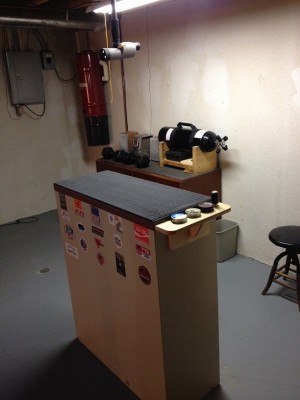

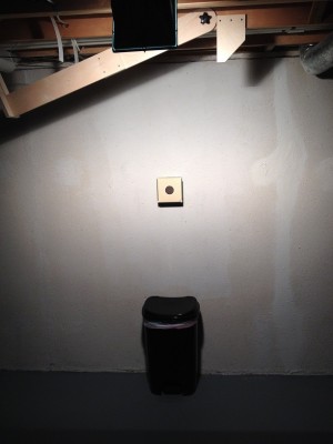

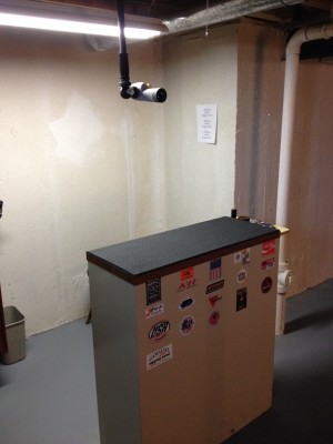

I also have an indoor range. It is ISSF compliant. Firing line has a bench with a rubber mat and a 20x spotting scope suspended from the ceiling, I only move my head a couple of inches to use. The target is in a Gehmann trap. Targets are illuminated by a 500w quartz lamp. There is also a chronograph that swings down from the ceiling.

Gort,
Very nice setup! I like your ceiling mounted chrony and spotting scope!
Bestshooter
Posts: 14
Joined: Sun Apr 17, 2011 11:26 am
Post by Bestshooter »
Now that is sweet !!! I wanna come to your place
