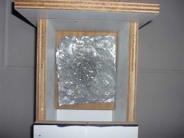

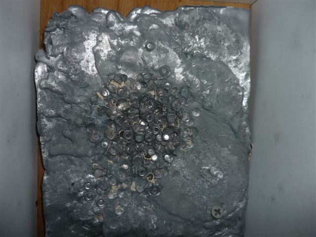

trap back
Hi
I use the very thing you are shooting ( LEAD) i just collected up all used pellets at my club ,made a 150mm sq mold from scrap timber ,melted up the used pellets and its done :150mm sq,10mm thick lead plate .You could also use a metal camping dinner plate as a mold
No noise or bounce back what so ever and the pellets you fire, stick to the lead plate and build up . after a while just peal the pellets off and reuse for casting .
See pics cheers S
See pics cheers S
- P1010513.JPG (44.72 KiB) Viewed 4093 times
- P1010514.JPG (54.52 KiB) Viewed 4093 times
