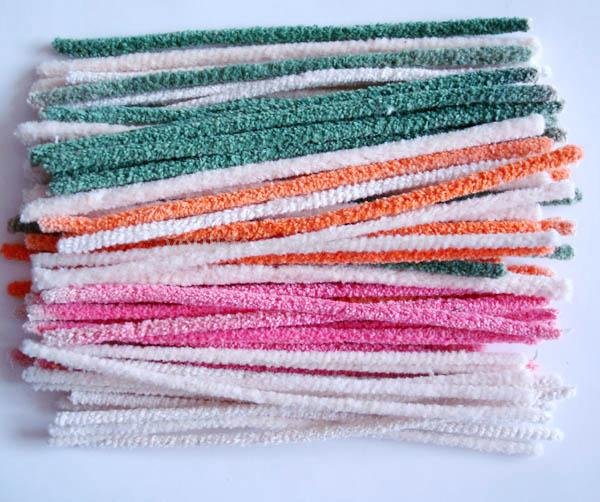

To clean this compensator http://www.morini.ch/fotoart/82.jpg (for the Morini 84E) sometimes I use pipe cleaners
