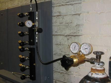

OMRC Nitrogen System
- OMRC Nitrogen System.jpg (22.3 KiB) Viewed 6039 times
- OMRC Nitrogen System 2.jpg (23.54 KiB) Viewed 6039 times
- OMRC Nitrogen System 3.jpg (20.74 KiB) Viewed 6039 times
I think the benefit of using N is you do not need a card saying you are a "diver" to get your tank filled. For 5 years I drove by a dive shop which would not fill up my SCUBA tank. I had to ask a friend to fill it up for me or drive 45 mins out of my way to go to another shop who would fill it without being a "diver".
