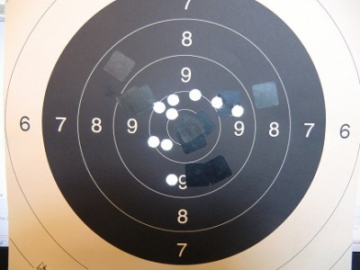

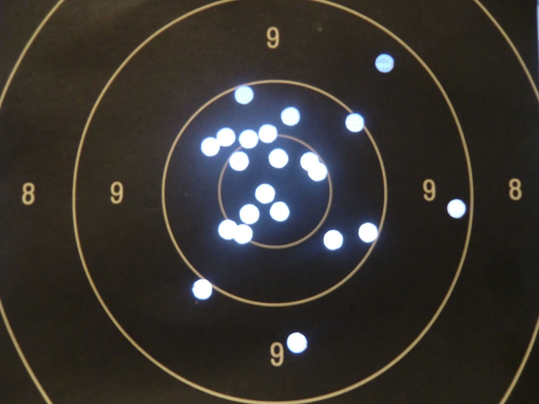

Tonights rapid fire practise, 22 rounds, and 11 of them inner tens.

MFR wrote:Tonights rapid fire practise, 22 rounds, and 11 of them inner tens.
There is no revolver or pistol that would give that kind of results in my hands. I'm working on it, but it's a long way to go before I'm even close.
Mika
