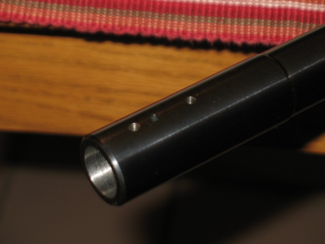

Time to clear up a myth: There is no problem cutting an Anschutz barrel from the front end.
As Grizzy states, there is a slight choke to the muzzle end of the barrel. This choke gives the barrel a little extra life but actually degrades the accuracy a little bit. Both Karl Kenyon and Neal Johnson used to regularly set the muzzle crown of an Anschutz barrel back around an inch and a quarter to remove this choke. The result was pretty much universally a more accurate rifle.
I am attaching a picture of the muzzle on my 18xx heavy barrel. Done by Karl about 20 years ago. Torqued and matched to ammo I get .35 caliber 5 shot groups at 50 yards. The crown goes back to about halfway between the two rear sight block screw holes.
Cutting the Anschutz from the front is a perfectly reasonable thing to do and so long as it is done by a competent gunsmith who knows how to work with smallbore target rifles this should not be a problem. Now, if you like you can also remove the barrel cut some off the back and have the chamber made a touch tighter and the headspace reduced to minimum to improve accuracy a bit more but this is not necessary.
Don't be afraid to cut from the front.
'Dude
Choke removed from muzzle by Karl Kenyon.

I wont start an arguement with 'Dude, but I think that the choke is important. My gun averages about .220 groups at 50 M. It has a choke.
Are you sure that the gun is too heavy? It might just be muzzle heavy.
Matt

With regard to the original post, it has been said essentially, a rifle that is 10% or more of the body weight is just too massive, regardless of the balance point. I also note TENDOT says the legs are 41 inches apart. Without pictures this seems like a lot to me, even if you are going from outside edge to outside edge of the feet. Perhaps a position with the feet closer together would reduce some of the strain on the lower back. Without pictures, just conjecture.
Was not trying to start an argument about the choke or taper so much as dispel the myth that the choke at the muzzzle on the Anschutz barrel is somehow sacred. I have listened to people go on in great discourse about how the choke on the Anschutz barrel is somehow magical and if anything happens to that choke all the magic goes away. At the same time I have two Anschutz barrels where the choke was deliberately removed and they shot better after doing so. ...So much for the choke being magical.
Note that does not mean that if I removed the choke on a third Anschutz barrel that would necessarily improve that one as well but I would not be afraid of doing so.
A number of other people have noted they had barrels cut from the muzzle end and they shot fine when done.
What I take away from this would be you can cut the barrel from either end. So long as it is done by someone who knows what they are doing using machinery in good shape you will likely be no worse off in the end than when you started. If the job is done with some planning you can easily end up with a better barrel.
Sorry there is no cheap solution to the barrel problem.
In the "by the way" category a few folks have mentioned 0.22 groups. I assume that is the center to center distance. In my first post on the thread I noted .35 caliber holes from a barrel with the choke removed, I am old school, this is outside extreme to outside extreme, in center to center terms that works out to 0.17. Will it do it every time?, no, a typical 5 shot group is probably in line with the other numbers cited. Now this is with the help of one of Eric U's tuner tubes, some careful work with a torque gauge and selecting a lot of Eley.
At the end of the day, you just have to do what makes you comfortable.
