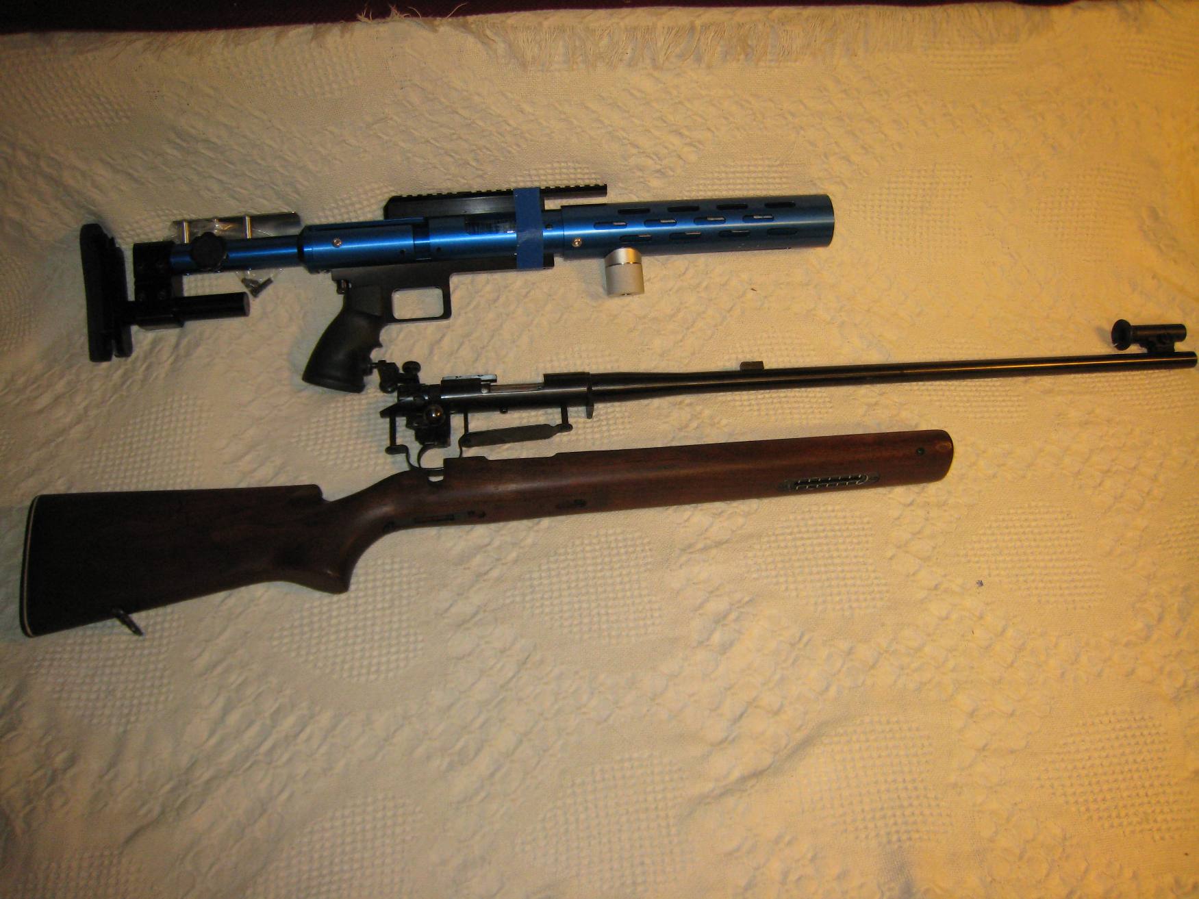

I have one and like it a lot, BUT...
You've have to get completely out of position for loading every shot in Prone or Kneeling. Off Hand / Standing isn't bad, but you'll also have to open the loading port up quite a bit to get your big fingers holding a tiny .22 into the area to load it. It's fine for HighPower, but not really suitable for Smallbore Position work as far as I'm concerned.
