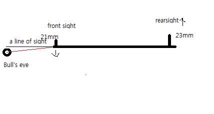

I am using FWB 700 wood model with 23 mm elevated rear sight and 21 mm elevated front sight. My problem is, it is really difficult for me to relax my shoulder and neck because the rear sight height is still too low. I have to force myself to lower head when I am aiming. I tried elevate the rear sight height more but once I do, I must elevate the front sight height as well. This results in the elevated line of sight, which means I have to change my entire position to get the bull's eye on my aiming line.
I have also tried to elevate the rear sight more while leaving the front sight lowered, for example, 31mm for the rear and 19mm for the front. This does not work at all because the FWB rear sight crank covers only 2 mm difference.
I really want to know how I can fix this problem. If there's any good way to do so, please tell me. Thanks in advance.

Simply speaking, what I actually need is, make the rear sight more elevated while lowering the front sight. Then I can have a upright head position without changing my entire position including buttplate, left arm, feet, waist...etc.
However, this is impossible because in order to do so, I must have some rear sight that can click 10mm or 20 mm lower. The FWB rear sight has only 2 mm adjustibility.

If you do that with the sights, your pellets will impact high.
Think of it this way, clamp the rifle, without sights, so it cannot move. The rifle will only shoot in one spot. Now add a front sight. The rifle is still shooting in the same spot. You can look through the front sight at many different angles, but only one specific line of sight puts the spot the rifle is shooting in the center of the front sight.
That line of sight will pass directly through the rear iris. And that goes for anything you do it the sights. Otherwise, you'd need to hold off to make the shots go in the center.
Now back up to a clamped rifle with a front sight. Add a 10mm riser to the front sight. That would raise the line of sight to aim where the rifle is shooting 10mm at the front sight. For the sake of simplicity, lets say this raises the line of sight at the rear sight by 10mm as well (not the case in real life where it would be slightly more than 10mm). That means the rear iris would need to be 10mm higher than our first setup. Should you not use a 10mm riser in the back, then to center your sights and shots, you would end up clicking up until the rear iris moves up those 10mm.

This might seem like a stupid question but as a pistol shooter I don't get to play with rifle sights too often.10mair wrote:However, this is impossible because in order to do so, I must have some rear sight that can click 10mm or 20 mm lower. The FWB rear sight has only 2 mm adjustibility.
If you raise the rear sight by 20mm but then want to adjust it down by 20mm, don't you end up with the eye positioned in the same place as if you hadn't raised the sight to start with?

I think the problem is that you seem to want to raise the rear sight only but still have the same sight line as if you hadn't raised it. The only way I can think of doing that is by using mirrors or prisms, but they're not allowed under ISSF rules unless you're using right shoulder and left eye (or vice versa).10mair wrote:I already know all you said above. I do not think you understand what I want to know, or I wasn't clear enough. Thanks anyway.
