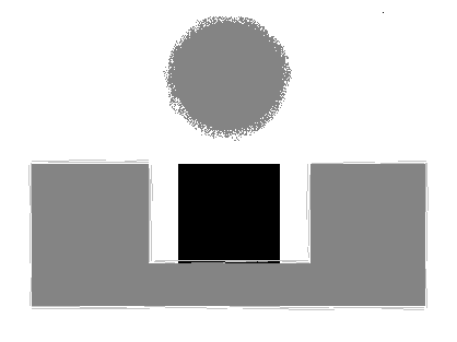

I use a foresight width so that in my shooting position the sight picture gives me the appearance of the foresight as the width of the black.
I try to then set my rear sight depth so that the foresight appears as a square in the rear sight and the light bars are about 30-50% of the forsight width on each side. My area aim is then with a similar light bar below the target black.
For each range with different lighting you may have to alter the rear sight width as various light levels will alter the sight image a little.
- sight_picture.gif (3.56 KiB) Viewed 9211 times
