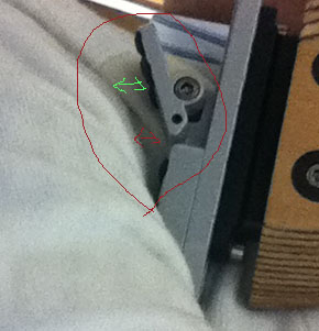

I play 10m air rifle. Recently, I am having a difficulty in keeping the butt plate hooked. When I start aiming and try to relax all my muscles, especially right shoulder and left arm, the butt plate gradually gets out from the shoulder or uncontacted. As a result, I become unable to relax my left arm muscle because once I do, the rifle drops to the front sight direction.
I know some people use the benefit of shooting jacket in keeping the butt plate contacted at shoulder. But, I guess it is not the best and right way to handdle this problem because I see many olympic players having no problem of butt plate when they shoot without shooting jacket as well.

- 2.jpg (40.53 KiB) Viewed 5195 times

Right. But, isn't it against the ISSF regulation? Can I see a pic of your buttplate plz? Thanks for your reply anyway.BGC wrote:Don't let the buttplate construction be a limit.
(My buttplate is home made out of two different buttplates.)
Perhaps you need to modify it a little to suit you.
Have you tried to add some spacers at the upper part of the buttplate?

A few things to try here: This looks like a well articulated buttplate, flatten out the lower tail, while adding more angle to the top extension. (keep in mind 20mm max dish). Next, if the adjustments allow for it make the buttplate vertically shorter. This will place butt higher in the shoulder but it appears this is where it wants to be so that would be fine.

Regardless of where the center of gravity is, I suspect you need to flatten the bottom portion of the buttplate some and allow the butt to rest higher on the shoulder. Probably slide your support hand further out on the stock to lower the natural point of aim some.

So you are working with a FWB 700 Universal. This helps for two reasons, this tells me which butt plate you have and also a little more about the stock. For all intents and purposes the stock on the 700 Universal is the grandson of the stock on the Model 600 which has a rather deep forend.

I had made reference to flattening the lower tail of the buttplate. This butt won't do that but in some ways that is a good thing. Just make sure the top part is set so you don't have more than the allowed 20mm of dish to the plate.
