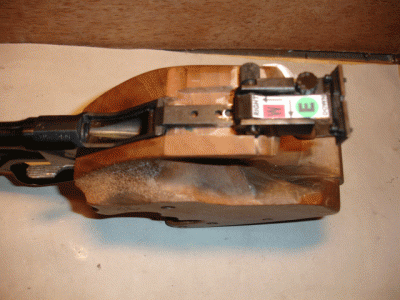

Here are the mods, 1 3/8" rear sight extension, front aluminum bar for balance, lots of metal out of the grip frame as showed in other pictures.
Absolutely a new gun, specially the reduced weight and better front sight focus, and now time to start all over again learning how to shoot it, hopefully not has many flyers!

rear sights
rear sights
rear sights
rear sights
