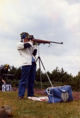

Its a long time since my wife and I shot 300m (Malcolm Cooper era) but then we only used 7.62 , .308W to you guys over the pond.
Eric is spot on, the recoil gave the shooter a mauling! I can remember spending hours trying to reload a round that did not knock my wife off her feet standing and still be able to buck the wind.
The picture is her shooting 300m in 1981 with a Sportco .308 action in a Walther copy stock, with factory Lapua 170 gn ammo, and a 1500 gm trigger. They built them tough then!
Good shooting
Robin
Good shooting
