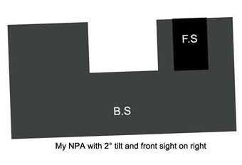

Thank you all for help, like FredB said there are some issues with my grip I'm forcing the hold it's not my NPA, need to find an expert for fixing it.
No my head is not tilting but as Mike and others advised I did some dry firing on spot with loose small finger and it seems works but still need to try at rage. Thanks Jessy, what you said is absolutely right, as Bill Horton advised I need to eliminate the change in gripping pressure as I apply the trigger.

NPA - This is my sight picture if I close my eyes and rise the pistol.

you can fix it
Biju,
If the third picture is how your sights look every time you raise the gun - i.e. your hand grip is very consistent - then you don't need an expert to fix your pistol grip. Just use the little grip angle adjustment screws on the frame to get your gun to point the way you want. Instructions are in the owner's manual.
HTH,
FredB
HTH,
FredB
If you need to force to bring the sight up it means that the grip is not raked enough for you.bijupaul wrote:Img 2 - Instead of let it go, I forcefully tried to bring the front sight up during the shot process.
You should increase the grip angle so that the pistol points at the right place when your wrist is at its maximum down position, i.e. when you do not need any effort to maintain the pistol horizontal.
You have luckily an LP10 that has these little screw between the frame and grip that allow you to adjust the grip angle (you need to remove the grip to adjust them).
Once you have adjusted the grip angle, you might also need to re-adjust the trigger blade position (if you increase the rake, the trigger blade might become too far to the front and you might need to move it to the rear).
