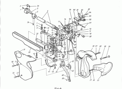

My Toz start 3 click 1 bang.
Firing pin doesn't be released.
During dismantling and clean, i missed the stecker spring... apart from that, trigger doesn't function: seems that lever doesn't travel far enough.
Any help?
Toz 35 click not bang.
Toz trigger malfunction
There have been previous posts which get into the resetting of the levers. During cleaning, if one moves the levers when the limiter isn't positioned, the levers may become out of synch. There is a stirrup and pin system which can become disengaged and needs to be reset. With the hammer out, the connection between the two levers can be checked easily.
