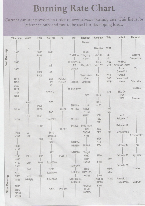

.32 Pistol Powder Burning Rates
Post by Popeye »
David M - Hmmmmm - I like the way you expressed the notion - that WST powder has a slow burning rate relative to other common .32-.38 pistol powders. You have the skills of an Accountant or Statistician!
Overall, I have the view that relative to other powders, WST is one of the faster burning powders but I suppose most pistol powders have faster burning rates than rifle powders.
I've uploaded a chart I sometimes refer to - it's from the 2006 Reloading Guide issued by VihtaVuori. It shows that WST has a relatively fast burning rate-which is worth knowing when reloading-and which is the only reason why I'm responding to your post (rather than being pedantic!).
Thanks for your advice over the maximum loads for N310 for .32 reloads. I might try and reduce the load to 1.3gr from now on.
cheers

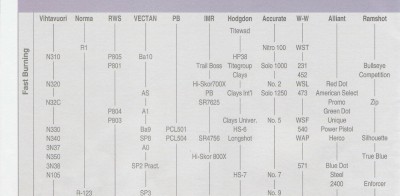

Popeye
Posts: 56
Joined: Wed Nov 29, 2006 4:52 pm
Post by Popeye »
Here is a close up of the faster powders in the chart. It's tricky when there is a cap on the size of the file! I hope it is clearer than the first upload.

Posts: 1719
POWDER BURNING RATE CHART
Be careful with powder burn rate charts as they will vary from case to case, load to load.
Here is a close list (includes some old and defunct powders).
These burning rates are relative and can differ from one cartridge to another and even from bullet weight in the same cartridge. They are not all the same type of powder (i.e. double-base or single-base) and should not be used as a loading guide. It is just to show you the comparison between types and brands to each other. Do not substitute one powder for another without checking the loading information for the powder you plan to use.
