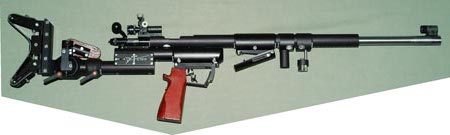

If you want something that is completly adjustable I would suggest a RMFTC an English made stock for 19 series Anschulz barreled actions
http://www.rmftc.eu/index.htm
Happy shooting
Happy shooting
