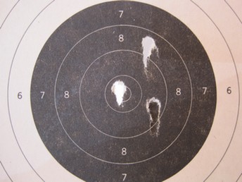

Attached is a pic of a B-40 target with strange holes in it. Usually i get 3 circles but these are becoming more common. What's going on?

Low velocity.

1 - low velocity (even Edelmann targets will tear when the pellet velocity is low <320fps?), and or
2 - target quality

Either you switched paper, or your airgun is lost some velocity. Same pellets as usual?
So what gun? Do you have access to a chronometer?

do you have a dehumidifier in the range? perhaps the targets are soaking up humidity?

1- Are you using wadcutter pellets?
2- Seals may be defective on the gun?
What gun are you using?

using LP10E with wadcutter pellets ...high quality ones from ChampChoice...
i will try putting some silicone grease on top of the o-rings ...

I agree , too slow .............

when you say "hi quality" did you mean the targets?? From the example you provided you have the possible issues.
Your losing air giving you a slower pellet
Your paper target is an NRA B-40 paper target either by American Target or National target. It could be a Speedwell too but unlikely. The paper type targets will rip like that with ANY drop off of speed to under 350fps. The NRA targets, even with perfect PCPs can give you odd holes/tears. Groups can be impossible to score too.

why am i getting low velocity pellets?

You should try other brands of targets and see if they will do better.
Also, the LP10E should shoot above 500 fps when using pellets that weigh
between 7.0 and 7.5 grains.
I don't see any reason why it is not punching out perfect holes...

Bad quality targets is my opinion. From the photo this is not an Edelmann or Krueger target. High quality targets even in low velocity have flakes break off not long tears like this.

the targets are from National Target Co...i have no chronograph...my lp10e is brand new right out of the box...i practice by myself as there is no one in my town that does AP...

National is about the worst AP target next to Beeman. Put a used target behind a new one and see if the hole is cleaner. It's probably not your gun.

Kruger targets are probably the very best available - your LP10 will be perfect if straight out of the box, new, and from an official distributor.

I used to get that sort of tear all the time with cheap American targets. I strongly suspect his pistol is fine. The only way to tell for sure is to chronograph the pistol and/or try some quality targets.
Las Vegas should be dry enough that humidity is unlikely to be the culprit.
You would think that humidity would be a big factor, but I've used National targets that have baked for years here in the driest climate in the country and would tear even with the higher powered guns.
As I said, try doubling up on the targets since they "bow" when hit by a pellet, sucking up the energy that should be used to penetrate them.

I think i got it figured out. I've raised my pellet trap up higher so i am not shooting down like i was. I'm no longer getting those weird shaped holes.
