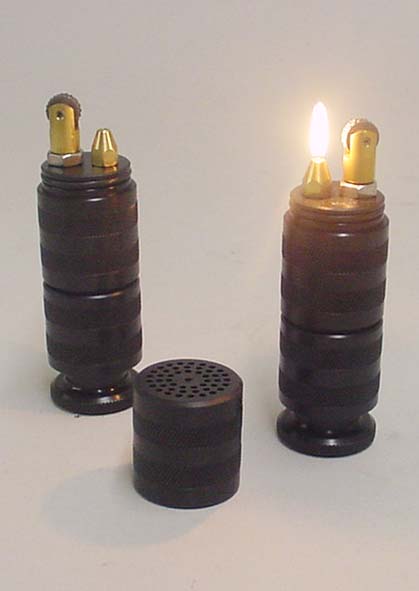

Can I assume he's talking about the old acetylene (calcium carbide) lighter that we used 40 years ago? Little silver canister, put in a rock of carbide, add 3 drops of water, close it, strike the flint and stand back !!!
I may have an extra but getting the carbide might be dodgey.
mister G wrote:Can I assume he's talking about the old acetylene (calcium carbide) lighter that we used 40 years ago?
No, I think he's talking about something that looks like a Bic cigarette lighter but has a very smokey flame. It's much less hassle than a Gunsmoke carbide lamp but, IMHO, gives almost as good a result.
http://ahg.anschuetz-sport.com/index.ph ... 07fafdb81b
(They frequently change the lighter style and colour but you get the idea)
I don't remember seeing them in the US, but American shooters have returned from Europe with them and shown them to me.
They are like the "BIC", but filled with acetylene.
The calcium carbide for the "Gunsmoke" is easy to come by and we have several cans around the club for free use by the shooters.

Don Nygord used to sell the"Bic" lighter type, "Anschutz black match" looks like the same thing. Their may be shipping restrictions (acetylene), no one seem to sell them in the USA.

Calcium carbide and water make acetylene, versus the acetylene filled lighter.
