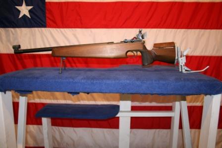

Here's another choice
Anschutz Match 64 action. All Stock work done by Bill Earnest (ESP). Rifles with or without Anschutz Sights. Your choice Make Offer.
viewtopic.php?t=22595
- I have two left.
