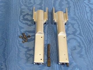

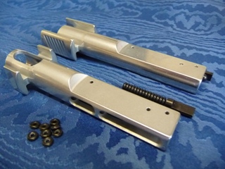

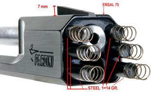

The SP-RF & SP1-RF have 6 tungsten rod weights to add more weight to the front of the gun...They actually increase the front weight of the RF gun 30-50 grams depending on whether it is a SP or an SP1… The regular gun has the same 6 rods but made out of steel.
The second difference is that the slide in the RF is a little lighter in order to make the action faster...
I don't think that there are any changes inside the barrel...Why would Pardini or any company would have to change the inside of a barrel for RF?
The barrel (plain barrel with no attachments) has a chamber, a twist rate and certain number of lands and changing these variables in no way will improve RF shooting...So…Why change it?
It is a fact that the barrels for the SP and SP-RF are made from the same steel and have the same thickness (similar weight)....
You can buy the tungsten rods from the SP-RF and use them in a regular SP or SP1 and then the only difference would be the lighter slide in the RF.
I may be missing something, what makes you think that these 2 changes or differences mentioned above will make the RF gun less accurate compared to a regular SP or SP1?

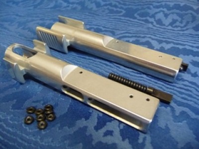

Pardini definitely says that there are “changes to the bolt and barrel” but Pardini considers the front part of the pistol just ahead of the barrel as part of the barrel itself even though this is part of the recoil reduction system.
I visited a dealer in Spain and saw both guns; he assured me that the differences were two: The front part of the barrel (6 TUNGSTEN weights & springs) and a lighter slide. The expensive part is the slide...
This dealer (he shoots a Pardini SP1) had a "RF kit" for the SP new on display and it consisted of 6 tungsten weights with 6 springs and a lighter slide all packed in a Pardini box...So I will assume that this is something that the factory offers to shooters competing in both disciplines with the same gun.
The dealer told me that the weights, springs and slide for the SP New were also available for whoever had a RF pistol and wanted to convert it to a regular SP new but that this situation was not as common (we all understand this statement).

The cycle rate in the SP is fast enough for shooting rapid Fire without any problems…If a chamber is very tight, it will jam either gun (SP or SP-RF) so I don’t believe that this argument about a less tight chamber in the RF is valid.
The lighter slide in the RF is for increasing the cycle velocity so the shooter has more time for recuperating from the kick…For example: If the lighter slide makes the cycle 30% faster, then the shooter has 30% more time for recuperating from the previous shoot.
The RF has more weight in the front (6 TUNGSTEN weights) because a lighter slide will make the gun kick harder and upwards…More weight at the very front part of the gun will compensate for this effect.
This extra weight will make the gun "Nose Heavy" and some shooter's don't like this kind of balance in a rapid fire pistol. I am one of them...
The barrel (Barrel with no attachments) in all four guns: SP & SP-1 new and SP-RF & SP1-RF has the very same part number: 702-1
The difference between the SP and SP-RF?
LIGHTER SLIDE, TUNGSTEN WEIGHTS & SPRINGS…And the “1” is for the Electronic Trigger in either model…

Alberto Trincia added that during the last year they have made more changes to the SP-RF: “Since last year we also have a new bolt with an integrated damper. Thanks to the removable elastomer rings (O rings) it is also possible to personalize the recoil absorber hardness”
Summarizing: The SP-RF has less operating pressure that the standard SP but it doesn’t have an over-bored barrel. Both guns are very accurate but the SP is intended for more accuracy at the expense of a tighter bore-harder kick. My experience is that the average bore of a .22 RF barrel is .217 and .215 whenever a tighter bore is used, but these standards may vary slightly according to the barrel manufacturer.
For those who insist that the RF is not as accurate as the SP, Alberto sent me some pictures for posting them in this thread...Please note that the target was shot with an SP-RF using Eley Tenex ammo which shows "dream" accuracy for a standard SP or for any other top of the line SP pistol and more than enough accuracy for any kind of competition...
