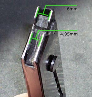

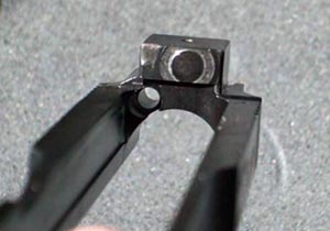

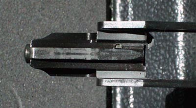

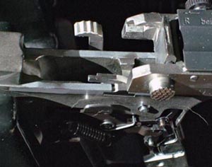

Here's some other bits and pieces to show the wear points on my gun.
- mag3.jpg (37.11 KiB) Viewed 12549 times
- mag2.jpg (39.26 KiB) Viewed 12549 times
- slide3.jpg (38.45 KiB) Viewed 12549 times
- slide2.jpg (40.7 KiB) Viewed 12549 times
- slide1.jpg (45.42 KiB) Viewed 12549 times
