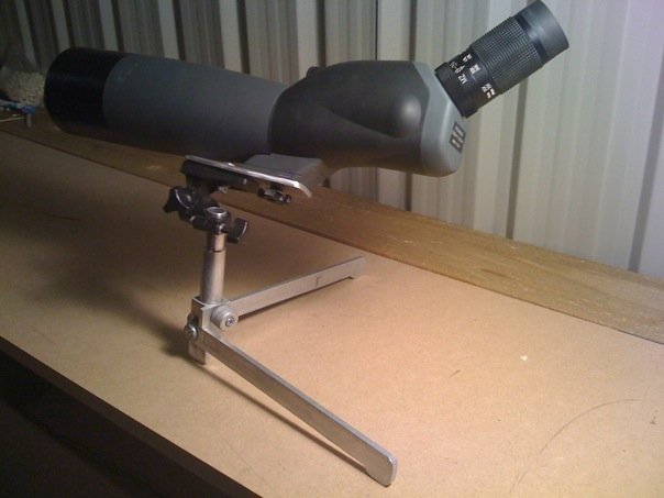

Helping a Kiwi make a Scope and Scopestand order from NZ
Hello Shooters
I have been using a good scope with a hopeless scopestand or the last 8 months of my 20 yard indoor shooting career! finally getting up to 98-100.5 cards looking at getting the best scope as the other one is moving about getting in my way and taking far to long to setup at competitions!
I used a friends scope and all I needed to do was look down and I could see without all the drama of looking across!!
Before I order make sure I have got it right as I am not 100% sure if the Zoom Head is the right one for the Celestron Regal 80mm 20-60X Spotting Scope
Freeland Bipod Scope Stand (with Zoom Head)
I am hoping http://www.championshooters.com with take order from New Zealand or do you know anyone who will or maybe cheaper?
- This my old stand and scope
- n654969912_2543919_1609335.jpg (34.96 KiB) Viewed 8442 times
- It is all on the wrong angle
- n654969912_2096280_7656.jpg (31.58 KiB) Viewed 8442 times

That scope stand is just what you need along with the zoom head. I have that same stand except the older version from 2 years ago.
As for that spotting scope, that looks real great. I personally use a Konus 65mm and hope to upgrade to the Konus 80mm before the Canadian Smallbore Championship.
Whether they will sell to New Zealand I am not sure about. I guess phone and find out.
Also if you shoot 3P I would highly recommend a weight to screw on the bottom of the stand so it doesn't accidentally tip over.
