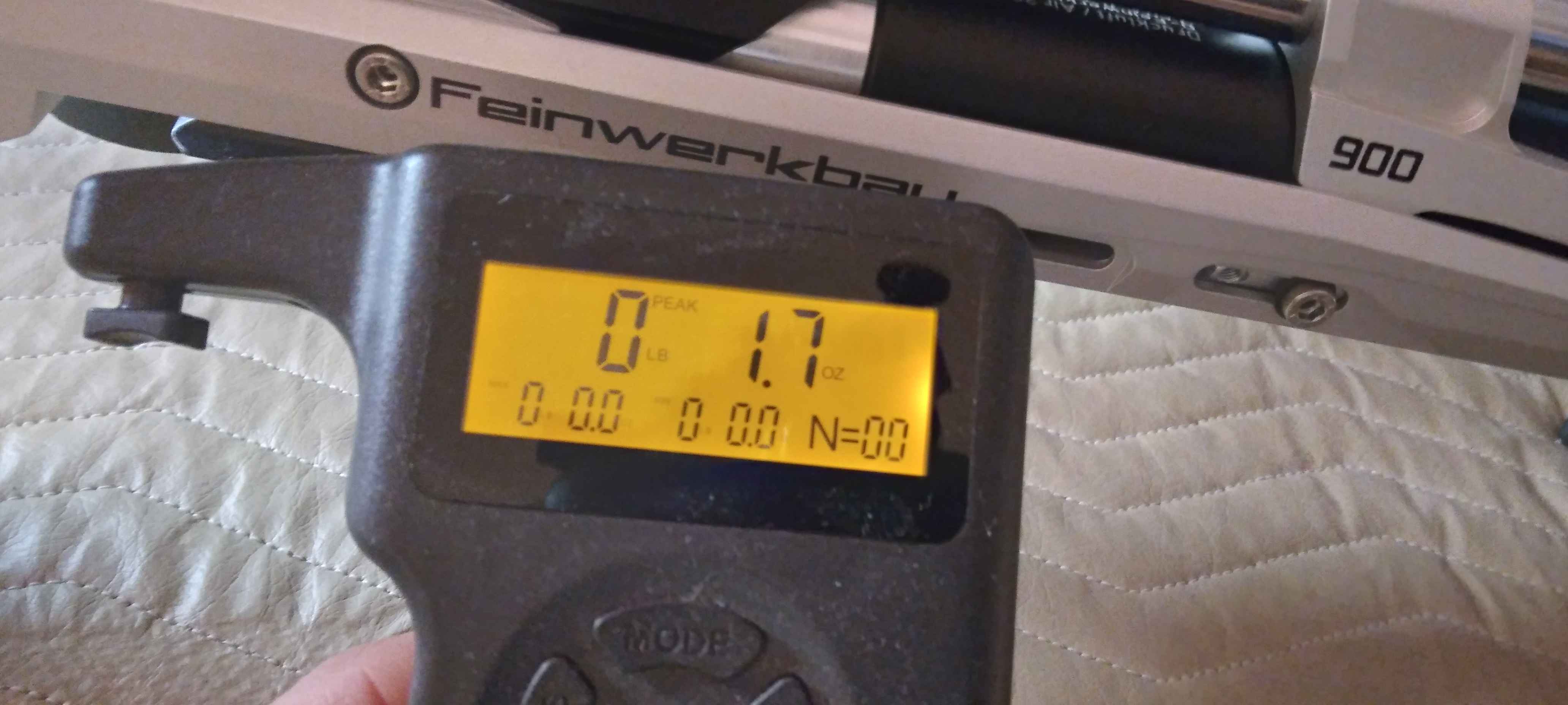

The last thing I do is put my finger on the trigger.
